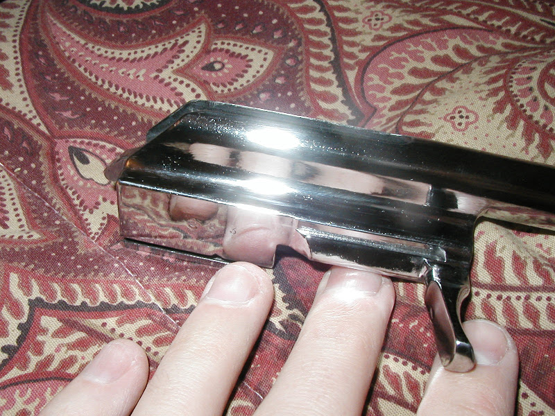

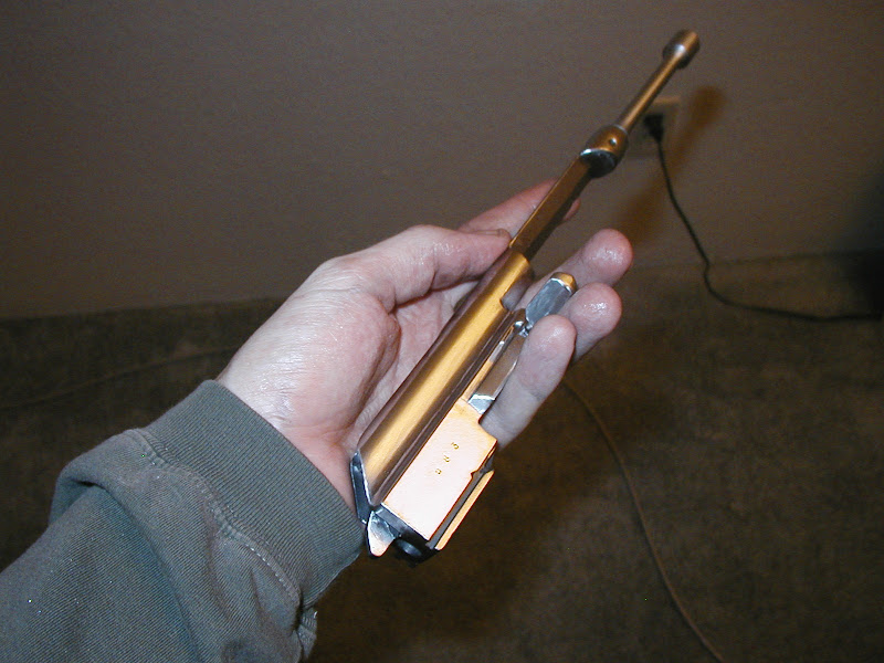

I am polishing my bolt and carrier right now. I found a really good combo with the dremel to get out the small imperfections and get the surface really smooth before polishing. The problem is... it is REALLY hard for me to get into the tight crevices on the carrier. Not sure how you people do it... :/
I have one rubberized disk that came with the dremel which is part #425. It is a rubberized emory impregnated disk which is slightly flexible. This alone will get the surface quite shiny, but I use it mainly for getting the surface flat and remove the surface imperfections from the factory. I then use the felt polishing wheels with red and white rouge compound to get the really mirror smooth shine. So far my bolt carrier is looking very nice. I just need to find out how to get in to the tighter spots. :(
So far I am only going to polish the bolt carrier and a few faces of the bolt (There are three that I believe that come into contact with the tops of the shells). So far it has made a noticeable difference when inserting a full mag on a closed bolt... nothing spectacular, but just enough that I can do it without looking now. :smoke:
I will try to get some better shots. This is my first time ever trying to polish anything on a firearm, so go easy. :D Will probably still send my bolt off to someone to do the modification cuts. I am not THAT brave with my dremel... :lolol:
This post has been edited by zenmetsu: 16 August 2009 - 12:10 AM

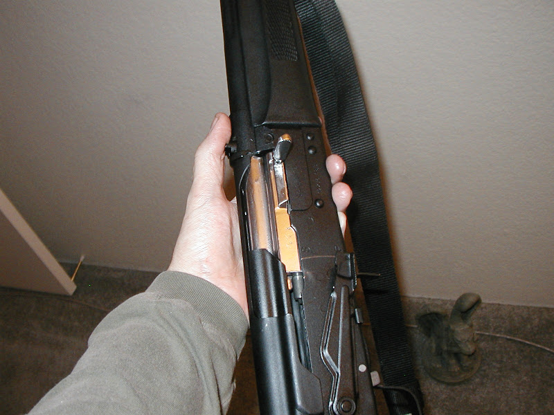

damned dust was already starting to cling to the oil..
I am happy enough with it. Now I have to wait for my conversion parts to come in. After that, i need to blast the thing and have it parkerized.
