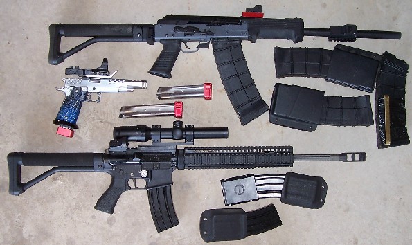

I was bored (and had a camera)...here is the whole pile of crap that I have to haul to three-gun matches these days. Holsters and mag pouches by Blade-tech.
And in response to the question about porting the barrel, here is Fred's prototype short gas gun with comp off the barrel. Note the angled porting and the vintage Savage Acu-choke system ph34r.gif
