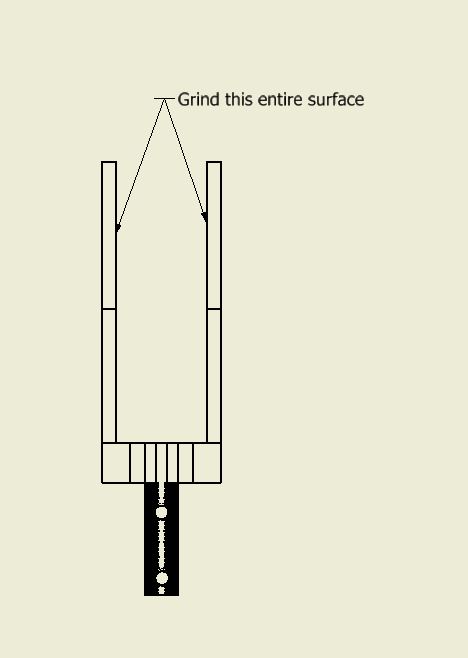

Perhaps a different rear sight block? Clearly from the pics of the milled and stamped gas tube lever there is a difference in width.
This is as far down as the rail will go.
The wider than stamped rear sight block just stops it cold from going any further.
That's because you haven't removed any material from either side of the hinge area! These are not designed to just slip on a milled receiver, you have just sprung the hinge to get it over the rear sight block, so yeah that's not going to fit like that. I have attached an image showing you where to remove material.
Share this post
Not having anything much beyond what's in the toolbox, what is needed to best grind away enough metal to get it to fit?
Thanks.
Share this post
We have a custom shop for fitting these now, call our customer service for price and time. If you want to do it yourself, I would used an angle grinder, just remember to remove same amount from each side until it fits.
