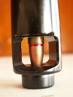

GregM1 241 Posted September 2, 2010 Report Share Posted September 2, 2010 (edited) Post Apoc's pics are of a 30cal 74 brake. Here is a pic of a 22cal 74 brake with a 30cal bullet in it. see the difference of how much less of the 30 cal bullet fits through it. This extra clearance will be required if you do not want the shot interrupted or misdirected. A buddy was shooting his rifle with a cheapy brake and each shot would rub the exit hole and misdirect it by several feet at 25yards. i think the bullet may fit through a 22cal brake but even a glancing touch will put your shot in the wrong county. Edited September 2, 2010 by GregM1 2 Quote Link to post Share on other sites
nalioth 405 Posted September 2, 2010 Report Share Posted September 2, 2010 Post Apoc's pics are of a 30cal 74 brake. Here is a pic of a 22cal 74 brake with a 30cal bullet in it. http://farm5.static.flickr.com/4004/4664967967_5209e650c5_z.jpg Your picture doesn't prove anything, either. The case is getting in the way. A buddy was shooting his rifle with a cheapy brake and each shot would rub the exit hole and misdirect it by several feet at 25yards. Military issue brakes or quality US made copies do not have these issues. Buy cheap - get cheap. 1 Quote Link to post Share on other sites
nalioth 405 Posted September 2, 2010 Report Share Posted September 2, 2010 (edited) Here is how you take pictures of this sort of thing. This is an East German 5.45x39 zig-zag brake with a 7.62x39 cartridge stuck through from the business end. As you can see the cartridge case extends far past the opening, meaning that there is plenty of room for a 7.62 projectile to pass through. If you click them, both will open up to "biggie size" for your close perusal. I hope this clears up matters (at least until the next thread). Edited September 2, 2010 by nalioth 3 Quote Link to post Share on other sites
GregM1 241 Posted September 2, 2010 Report Share Posted September 2, 2010 (edited) Buy cheap - get cheap. agreed, but i just wanted to relate that if there is even slight contact with the smaller diameter exit, that will cause problems. Edited September 2, 2010 by GregM1 4 Quote Link to post Share on other sites

shades_of_grey 1,092 Posted September 2, 2010 Report Share Posted September 2, 2010 nalioth, usually, (almost always), your assertions are correct, but I think you're wrong on this one. Here are some more (huge) pics of my brake, similar to the ones you posted, for comparison's sake: ^ That's the proper amount of clearance for a 7.62 round. 1 Quote Link to post Share on other sites

gregomega 929 Posted September 3, 2010 Report Share Posted September 3, 2010 So, again after looking at pics on this thread, I decided to do a lil bullet test of my own and come to find out I believe my brake is actually made for 5.45. On P-A's photos, the bullet sinks down past the exit hole quite a bit more. My photo looks more to be like Nalioth's, which is 5.45. Ive shot 30+ rounds through it so far and no hits to the side...yet, that I can see. And being that I spent all day yesterday looking for these "milspec" brakes and have yet to find one, I say fuckit and im just going to get an Arsenal brake thats actually made for 7.62. Quality looks way better than all ive seen on here anyway. And if I happen to run into one lateron down the road, then good for me, until then I think ill have some kool-aid. Quote Link to post Share on other sites
