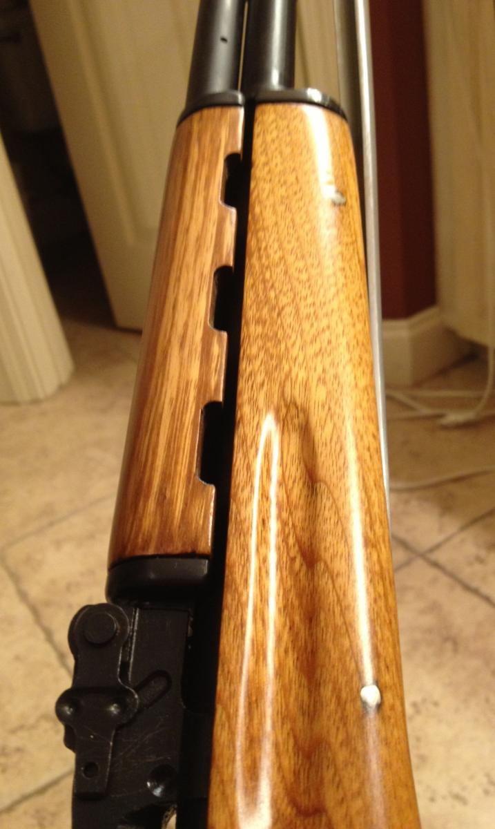

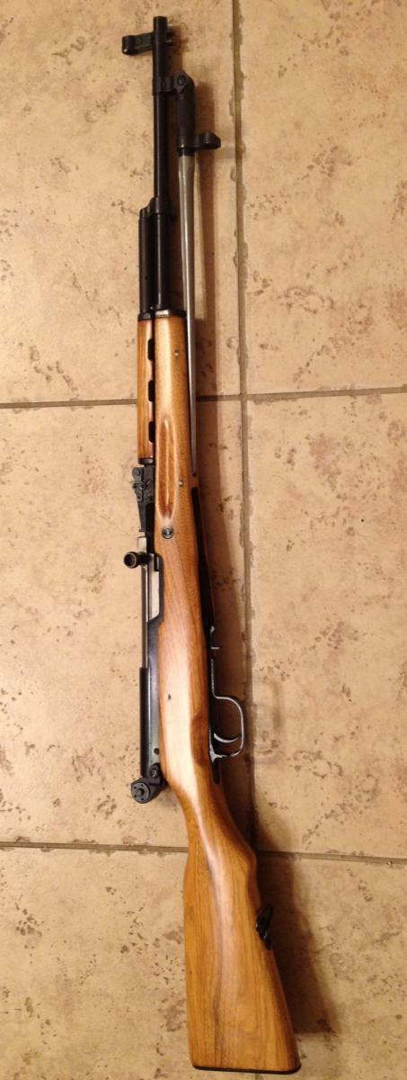

Spacehog 2,212 Posted February 4, 2014 Report Share Posted February 4, 2014 I received a 9696 factory Chinese SKS in bullpup configuration in a trade in December. I have since sold the bullpup kit and set about restoring the rifle to standard configuration. I wanted to share the final product as I am pretty proud of it. I know there are some on the board that will look down on refinishing the gun, but hey I had a blast, it looks nice, and I learned a lot about the trigger group. I refinished the stock by stripping to bare wood and sealing with 8 coats of Spar Urethane. One ding I could not steam out but it still turned out pretty well. It had a stamped trigger housing, and the edges were pretty rough, so everything got filed/sanded smooth and reblued. The trigger was absolutely the worst trigger I have ever felt, even by SKS standards. Severe negative engagement, a mile of creep, and about three rough "screeches" before it would break. I did a complete trigger job. Now it is 5.5 lbs, very little creep, smooth as butter, and has a nice positive engagement. Last thing I did was add a Techsight aperture peep to the rear. Overall it was a fun project. Here are some pics: 7 Quote Link to post Share on other sites

Spacehog 2,212 Posted February 4, 2014 Author Report Share Posted February 4, 2014 Whoa, that looks great! Nice job on the furniture. Thank you. I do a lot of wood refinishing. Time consuming, but seeing the outcome is always worth it. That one ding still bugs the heck out of me though. Quote Link to post Share on other sites
Billybobf 50 Posted February 4, 2014 Report Share Posted February 4, 2014 I actually like the ding, it makes it a beautiful restoration while still showing its use, age and character 1 Quote Link to post Share on other sites
Sim_Player 1,938 Posted February 4, 2014 Report Share Posted February 4, 2014 (edited) Very nicely done. It's gorgeous! About the dent... It's called being O.C. Stop looking at it. The rear peep sight is a nice touch. Edited February 4, 2014 by Sim_Player 1 Quote Link to post Share on other sites
Spacehog 2,212 Posted February 4, 2014 Author Report Share Posted February 4, 2014 Very nicely done. It's gorgeous! About the dent... It's called being O.C. Stop looking at it. The rear peep sight is a nice touch. That made me laugh. Yes I am OC when it comes to stuff like that. The entire time I kept thinking "why couldn't this thing be on the backside?" It's a minor thing though. I appreciate it. Quote Link to post Share on other sites
Sim_Player 1,938 Posted February 4, 2014 Report Share Posted February 4, 2014 (edited) Funny how something tiny bugs the crap out of me, until I put it back in the safe for a few days. Of course, if it was a gouge it wouldn't steam out. Edited February 4, 2014 by Sim_Player Quote Link to post Share on other sites
Spacehog 2,212 Posted February 4, 2014 Author Report Share Posted February 4, 2014 Funny how something tiny bugs the crap out of me, until I put it back in the safe for a few days. Of course, if it was a gouge it wouldn't steam out. Oh it was better than a gouge. It looked like the previous owner tried hammering a 16 penny nail with it. Quote Link to post Share on other sites

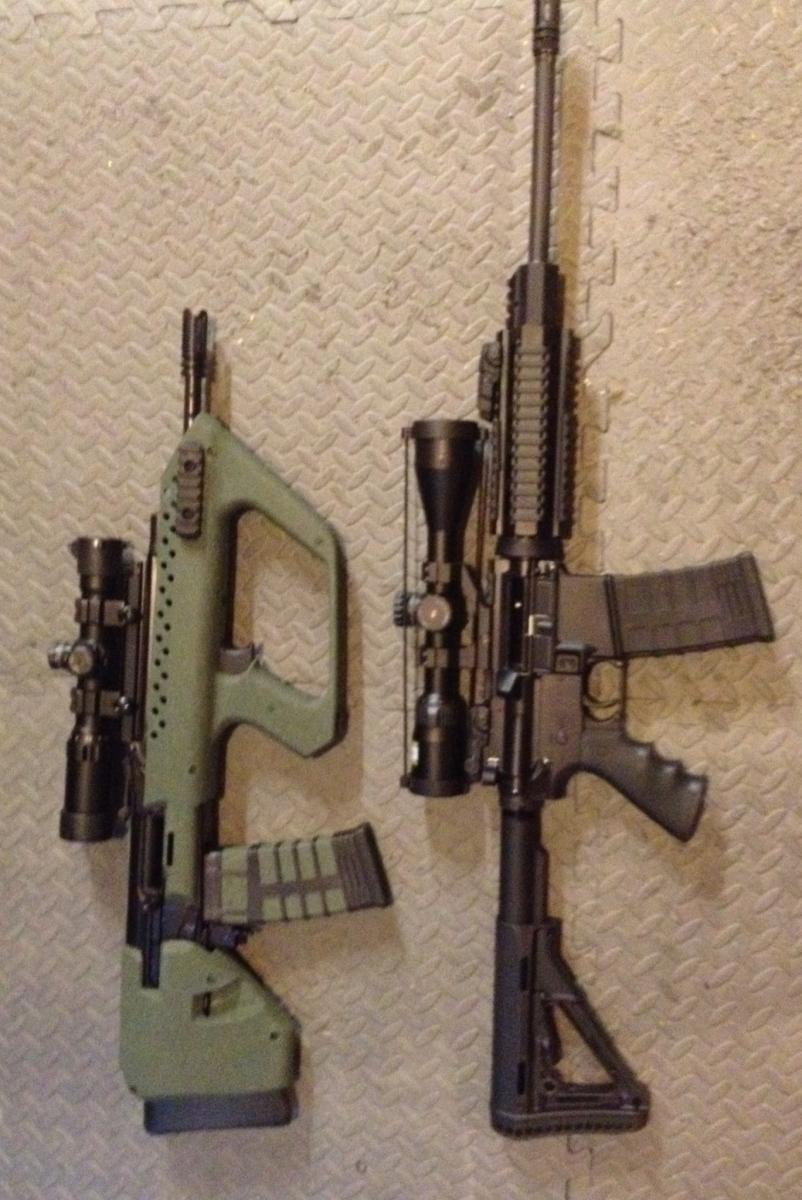

Spacehog 2,212 Posted February 4, 2014 Author Report Share Posted February 4, 2014 I'm a bullpup fan, but that's just sweet.You successfully bullpup'd a RPK. I would say you are a fan. I considered keeping it a bullpup, but I already have. .223 Kpup, and I like the look of wood on a rifle. Plus I was able to recoup half of the value of my trade by selling the Bullpup kit. Since you are a fan of bullpups, here is a pic of what the rifle looked like before I got started: Along with a pic of the only Bullpup I own: Quote Link to post Share on other sites
