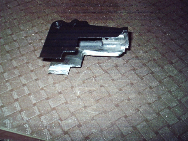

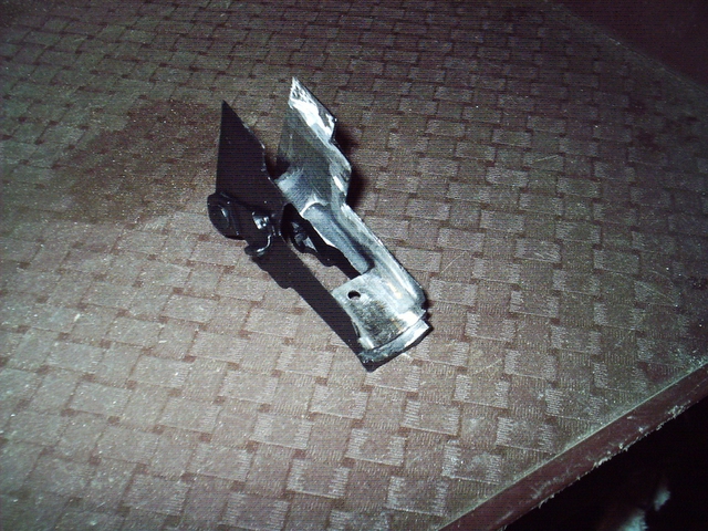

Cobra 76 two 2,678 Posted June 8, 2006 Report Share Posted June 8, 2006 It's no small task to mod a AK RSB to fit the Saiga 12 gas tube and trunnion. Just cutting it to fit is a bitch and then you have to line it up perfect and attach it. I used the JB method for lack of better options so forgive me for what I had to do to my baby to prepare it. OUCH! Not tryin to jack your post bro! I was the first though Quote Link to post Share on other sites

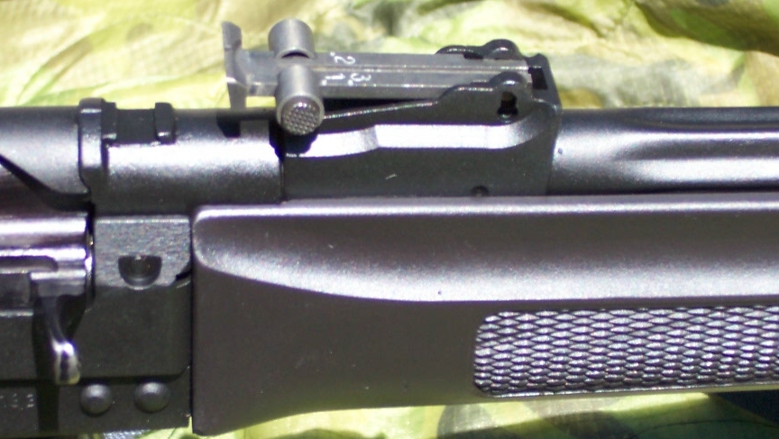

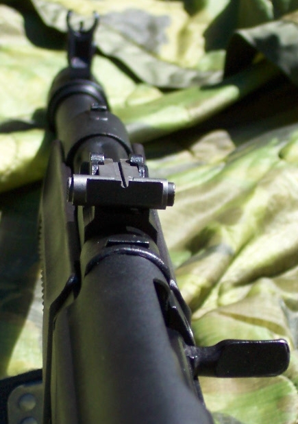

nycGUNguy 61 Posted July 8, 2006 Report Share Posted July 8, 2006 Here are a few shots of my full Cobra/Dinzag/nyclu3 conversion on my S-20 . I also have a shot of my brother's S-12 in the middle of his full conversion; lacking the gas tube/RSB/FSB conversion. I just picked up another AK kit for the completion of his and the start of my S-12 that I hope to order when I get back. Quote Link to post Share on other sites
epsylum 0 Posted July 8, 2006 Report Share Posted July 8, 2006 Here are a few shots of my full Cobra/Dinzag/nyclu3 conversion on my S-20 . I also have a shot of my brother's S-12 in the middle of his full conversion; lacking the gas tube/RSB/FSB conversion. I just picked up another AK kit for the completion of his and the start of my S-12 that I hope to order when I get back. Man that is sweet. Dinzag, how big of a PITA is it to replicate your work or would you or anyone else be able to do it for me (of course for $ ) ? I suck with things like that and am thinking about doing a Saiga 12 AK style conversion like that as a fun gun as my current S12 is my HD gun. I am thinking about something almost exactly like yours but with a Dragonuv style wood stock/grip that I would order from BRG3. This is not an immediate thing as I don't even have a second S12 yet, but it is on my wishlist. Quote Link to post Share on other sites
dinzag 31 Posted July 8, 2006 Author Report Share Posted July 8, 2006 (edited) nyclu3 - I love the AK'd Shotties!!! Nice work bro! epsylum - Thanks! If you aren't in Michigan, I can't help you much myself...I don't have a FFL. However, I am tight with a FFL/Gunsmith. I don't know the legalities of out-of-state gun work, but I can have him look into it. I can get you all the parts if you can find someone to weld the RSB on. Shortened & modded gas tube & shaved down RSB, plus lower retainer. Can do the raised front sight as well. I'd supply detailed drawings with key alignment dimensions. PM me & we'll hash out details when you are ready. It's pretty easy to duplicate, the main thing is fitting all the parts & getting that RSB square. I'm working an putting together a S-410 kit for a guy right now... Edited July 8, 2006 by dinzag Quote Link to post Share on other sites

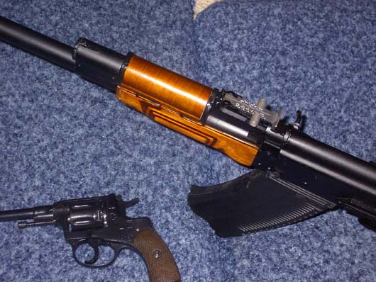

Lekss 0 Posted July 9, 2006 Report Share Posted July 9, 2006 (edited) Edited July 9, 2006 by Lekss Quote Link to post Share on other sites
Cobra 76 two 2,678 Posted July 9, 2006 Report Share Posted July 9, 2006 Looking VERY nice! I love Russian laminate. Quote Link to post Share on other sites
